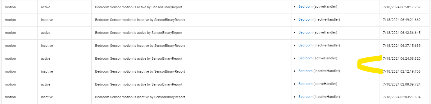

Also according to the event log on this device, Z wave clearly was not functioning between the time of the crash and the power pull reboot.

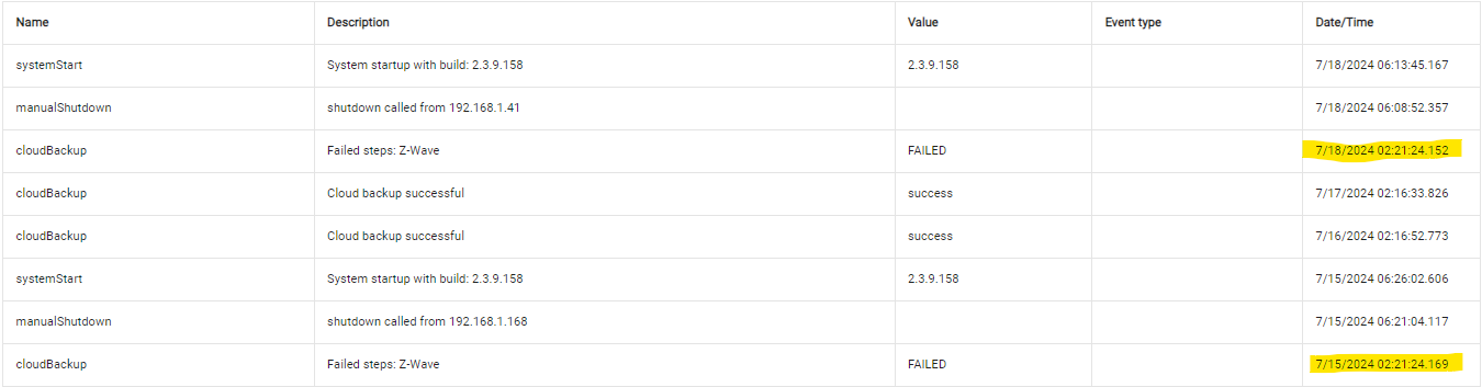

Update: It's been a little over a month since I switched this hub to the Hubitat power supply. I've had 3 z-wave crashes since, the third being last night coinciding with backup failed step: z-wave. Auto recovery does not appear to work in my case, or at least not in full. I still need to do a shutdown/power pull combo to restore full functionality to all z-wave devices. I kept this hub on .158 during this period.

I haven't seen any posts regarding this issue which leads me to believe it was remedied for others but here I am. I'm going to reduce my backup frequency from daily to weekly to reduce the chances of further crashes but I'm hoping I can get some insight on what might be happening.
