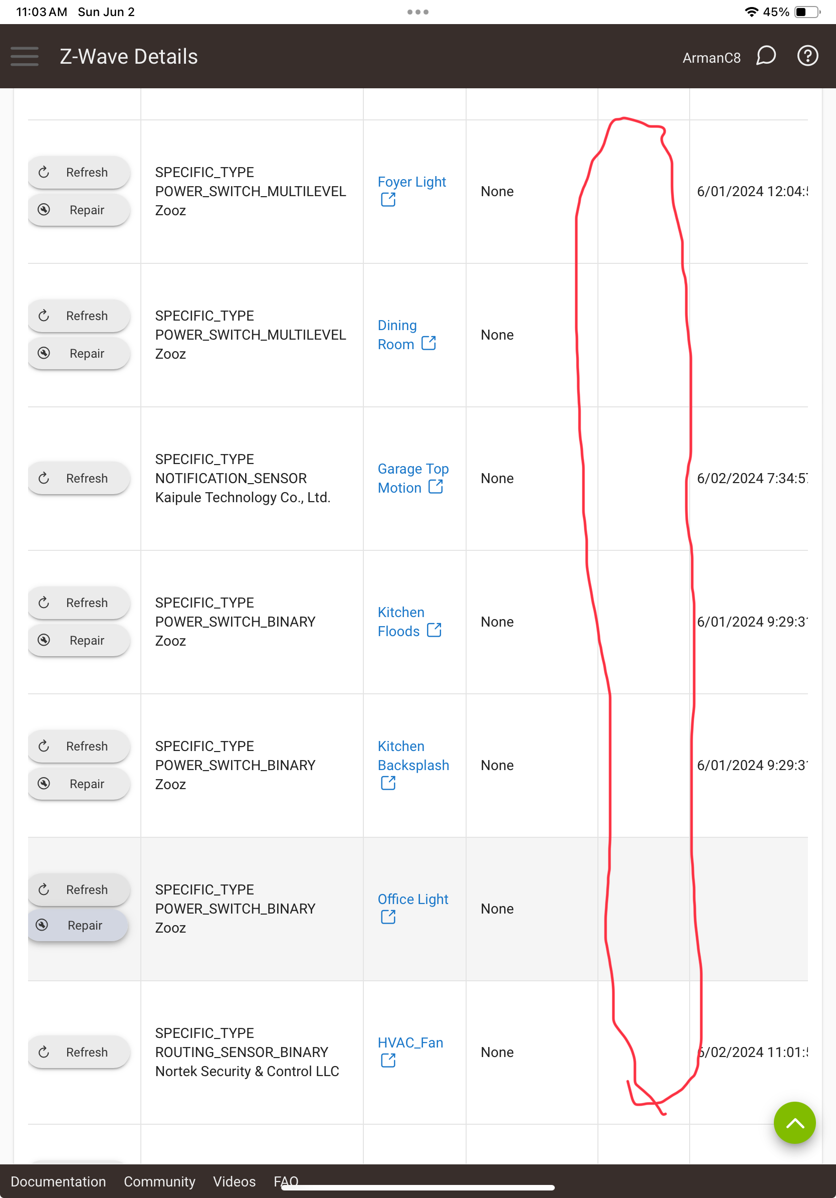

[2.3.9.143,C8] Looks like ghosts, but not - Solved
I have about 8 z-wave devices with no route in settings view but work well. Both battery and ac powered.
Last boot was ~9am yesterday when I upgraded to 143.
Any thoughts? Not causing any apparent problems.
If they are mains powered devices either clicking refresh there, or refreshing the device / cycling the device should get it to populate.
A lot of the info on that table is now being dropped when you reboot, instead of cached like it was before. Not sure if it was intentional or a bug, no one ever said during beta testing.
Don’t know what did it, but after checking them several times over the last 5 hours, when I went to try your idea, they all had routes populated!
You possibly just used the devices or they sent an update to the hub, that will populate the info usually.
