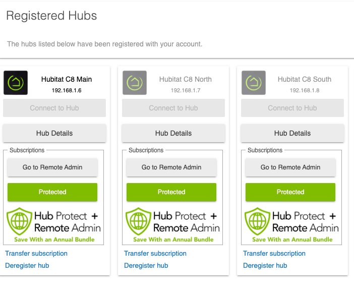

I have 3 C8s, one shows .145 is available, the other two show this:
Currently running version: 2.3.6.144
No updates available.
I have refreshed and rebooted - they just don't see the update available.
Make sure your hubs are connected to the cloud.
More details?

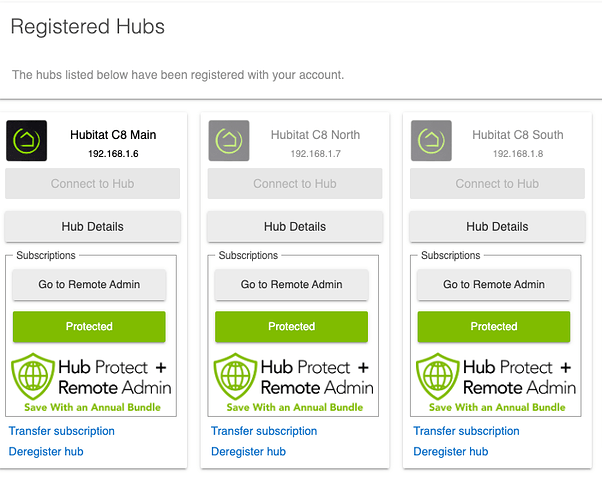

Not sure why .7 and .8 show gray - what am I missing here? This is first time this has happened.
If you click hub details it will tell you the last time it connected to the HE servers (last check-in).
They are probably not connected to the cloud. Have you changed anything with DNS?
You can go to the network settings > network test and then try to ping something like cloud.hubitat.com which will test the DNS and ping at the same time.
DNS issue is the main reason why a hub would not be able to connect to the cloud servers.
That and overzealous firewall rules or subnetting/vlanning. :wink:
This is fixed. All 3 hubs had "hubitat.local" as their network name. I used to have aliases configured in pfSense but after an upgrade there I was not able to restore my "whole" config and alias was one part that was corrupt.
