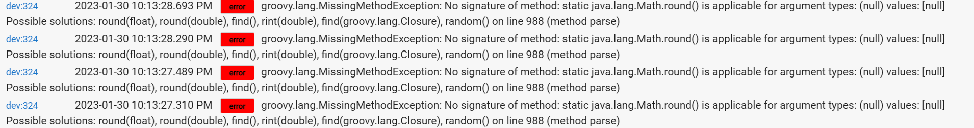

After installing .138, I received a burst of these error messages in the logs on two separate hubs

Device 324.
On hub named home, I get the same error for device 335, which is
This I believe is the inovelli supplied driver
