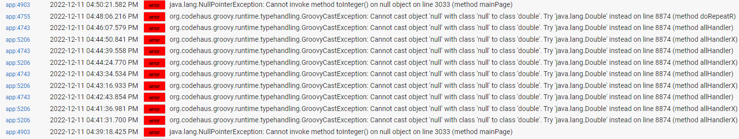

Found these errors in log from time the rename was preformed.
