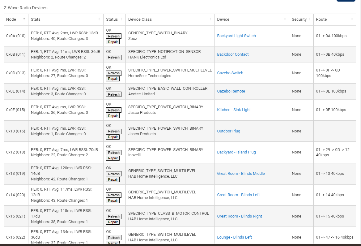

How's your z-wave table look?
since I have no idea how to read it.. 1/2 red , 1/2 blue :slight_smile:
No z-wave details page. Settings))z-wave details (screen shot all of it)
1 ghost - tried to get rid of it.. but no luck. and then the outdoor plug is not plugged in..
You shouldn't disconnect a mains based stuff like that. Between that and the ghost you will have delays in your mesh... The plug needs put back in or removed from HE altogether and that ghost should be removed. If you know the device that created that device needs to have its power disconnected, reboot the hub then remove the ghost. Or use a z-wave stick to remove the ghost.

As for "ghosts"--the new release seems to make some of my devices (battery powered usually) show up as not having routes. However, when I do a refresh and/or kick the device back to life, it pops back just fine.
Also, the past release or so, my "memory alert" notifications are popping pretty regularly on my "apps but no devices" hub. I know @gopher.ny said the memory stats were adjusted in some of the recent releases--and I've not tried to figure out if that's the issue or not (reboots seem to make it generally happier and when it trips my memory alert, it reboots that night; So, I figured that was a reasonable thing to let happen).
These are not ghosts, then (though this does seem to be scaring some people as much as ghosts do lately :smile:). A lack of routes in the Z-Wave Details table can be normal. The information is cleared on each reboot, so the device first needs communication with the hub. Then, it needs to wait for the table to actually get the updated information (I'm not sure what that schedule is, but it's not instant). This behavior is particularly likely with battery-powered devices, most of which (for Z-Wave) are are not listening for commands from the hub unless awake and only send things of their own as needed. No need to refresh or otherwise touch the device if there isn't actually a problem, which blank routes aren't per se.
