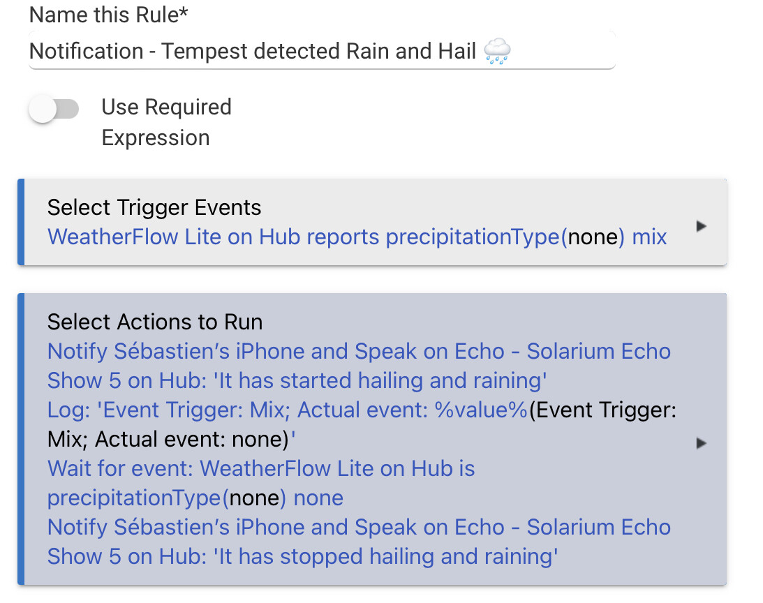

[2.3.2.134] RM not being triggered by one of a choice of Custom Attribute
@bravenel, I have a rule that is supposed to trigger on a custom attribute (Mix), but triggers on the wrong one (Rain).

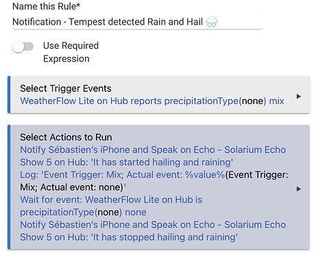

Rule:

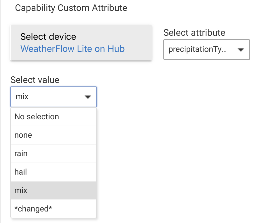

Trigger details and options:
Log:

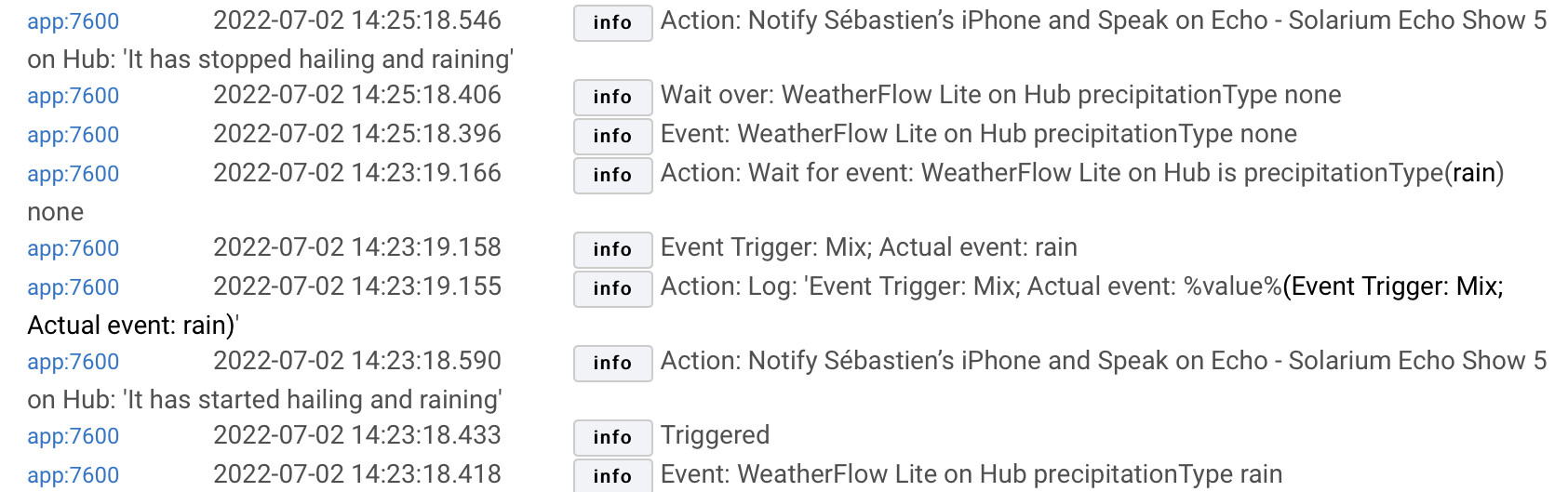

The logs show that the event type that triggers it is “rain” when it should only have been triggered by “Mix”.

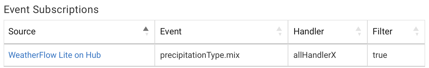

Please show me the Event Subscriptions from the App Status page.
Thanks! Here you go:
Well, that should only fire the rule with the event value of "mix". Using a different device attribute but similar, I can't get it to fail. This is hub code, based on that subscription. Please try it again, and post logs again.
Once RM is woken up by the event, it's not going to check anything. This the equivalent of subscribing to "switch.on". Pretty certain that works reliably.
Did you by chance happen to hit Update or Done since the above failure?
The reason I ask is that this all changed in 2.3.2. If this was a pre-existing rule, it's subscription would have been to "precipitationType". And that would indeed have fired on any event. Hitting Done since 2.3.2 would have changed the subscription to what you showed above. I forgot to mention in the release notes the need to hit Done for existing rules with Custom Attribute triggers.

Could it be that it was being triggered by the “rain” event because the “mix” event had never triggered before?
@bravenel: I assume this only impacts Rule. 5.x rules but would be needed for anything with a custom attribute trigger?
Thanks!
No. The only thing I can think of is that it had the wrong subscription. As I described above. These used to not include the ".mix" part at the end. But the code changed so that without that, it would trigger on any event for precipitationType.
For some Custom Attribute triggers -- those for things like this, enumerations of words. Custom Attribute triggers for things with numeric values are still done the way they were before.
Thanks! I’ll know to check the subscriptions if this ever happens again.
