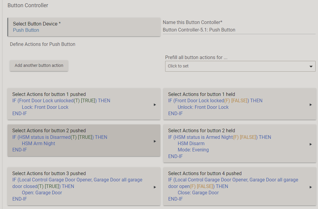

I had recently updated my button controller from 5.0 to the recent 5.1 release. Everything seemed to work fine, in fact, it seemed to work better than the 5.0. I updated the firmware of the Hub from 138 to 139 and the button controls are terribly slow or non-responsive. I am running a two button Walmote from Aeontec. I am using a custom device Handler driver. However, I did attempt to use the built-in driver with no such luck. All the button options are either slow or will not respond.
I ran a z-wave repair on the c-5 where all the rules are running from and where the button is associated with. The lock in this case is on c7, the lock works very other way. I believe is it is something with Button Controller app or software layer.

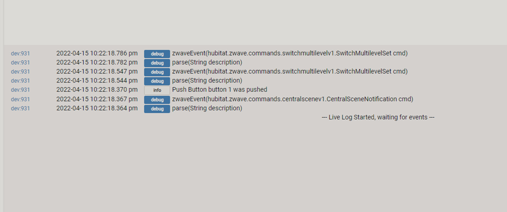

Can you tell where this slowness is happening? From your logs, the time from the hub receiving the button press in from the device and the dimmer reporting back that it was turned on was under half a second (and the time before it actually turned on was likely a bit less). That seems pretty good to me.
If there is a delay between the "real" button press and the first (bottom-most, in your screenshot) log entry, that to me would suggest a Z-Wave network problem more than an app issue; the hub is just having problems getting the initial button-press/scene report from the device for whatever reason. "Ghost nodes," chatty/spammy devices, or range issues are three possible causes for Z-Wave trouble, but if you haven't already done the firmware update from Settings > Z-Wave Details for your C-7 Z-Wave radio, that would be a good first step (the Firmware Update button, if you see it; if you don't, you're already up-to-date--and note that this is not the "Update" button). While you're there, comb the list for any ghosts--devices without routes listed are good suspects, unless they are battery devices that may have been sleeping the entire time since the last hub reboot, or perhaps a powered device you know if that just hasn't been used, but if you see anything suspicious...
There aren't any ghosts devices on the c7. From the time I press the button to the device responds is what I measuring, if it responds at all. The lock responds every single way from automated actions from the C5 without any issue. Only when using this button it's a problem on the C5. As you can see the hub is recognizing the button push.
Yes, the firmware is updated to on the c7. I'm confident that issue is on the C5 side and not the C7. The C7 and lock have a direct connection and it responds in every way quickly.
As you can see from my rules some the items that I'm automating is virtual devices and non-zwave devices and they have the same issue. Which would also exclude the C7 as well and z-wave network issue. Plus, I have button next to C5. So, I don't think it is a distance issue.
Let me know if that makes sense. Thanks for your help.

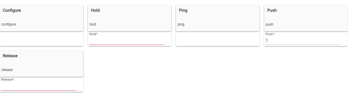

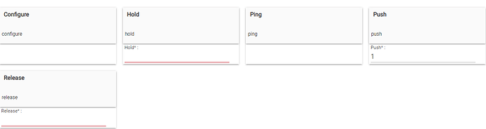

If I attempt button push from device manager no response.
Do you mean the device page, i.e., via the commands/buttons like "Push" at the top? If so:
  1. make sure you provide the appropriate button number (type "1", no quotes, or whatever number into the text box; this should correspond to the event and button number you'd get from a real push); and
  2. particularly if this is a community driver, it may not implement the push() command at all (it's a relatively recent addition, though it's been convention since more or less the beginning)--you'd likely see an error in logs, but you could also inspect the driver code to see what it does; and
  3. I assume you already know this, but keep in mind that this just generates a sort of "virtual" or simulated event and does not affect the actual device itself (nor would it troubleshoot problems with the actual device, but it can be useful for testing automations that should get "triggered" by the same event)
Virtual device could be Hsm. Which I am automating as per my screenshot above.
I tried the built-in driver either same results for the push button.
According to the logs I do have a push when I enter it in. I am using the correct number and type of push.
If I execute the action from the button controll app. It works. Not from device driver or from the physical device.
I am not talking about virtual devices or devices that you're controlling via the automation, just virtual/digital events (button events here, simulating "real" ones from the device) and events that would trigger the automation.
If you aren't getting a button event when you manually run a push(1) command (what you should get if you type 1 into the textbox on the Push button on the device page, then click/tap the button to run the command), then your app will not trigger--same as if it doesn't receive the physical event. This could be a driver issue.
But it sounds like your app does respond to physical events, just slowly -- or really, the app responds quickly, but it just takes a while for the button event to "register" on the hub compared to when you press the button in real life. Again, this strongly suggests some sort of Z-Wave mesh network problem to me. If any of these assumptions are incorrect, please provide clarification, since it will affect the possible source of problems. This is just what I think based on what I understand. :slight_smile:

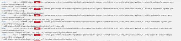

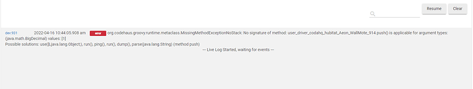

I'm still getting this
When I attempt from the driver. Other than that, it is working.
This appears to be a user (3rd party) driver, so the best approach would be to contact the driver author about this error.
I don't think the author is supporting the driver anymore. That's the issue. And the native driver does not have the features necessary for what the device is.
Might be a simple fix, do you have a link to the source code?
I have file but the link was taken down by codahq but erocom123 still has his link.
Updated by Ben Rimmasch (codahq) https://raw.githubusercontent.com/codahq/hubitat_codahq/master/devicestypes/aeon-wallmote.groovy
Originally written: Eric Maycock (erocm123) SmartThingsPublic/aeon-wallmote.groovy at master · erocm123/SmartThingsPublic · GitHub
The biggest advantage to this driver is the ability to swipe up or down as a third and fourth button. That's the big advantage to this device both dual and quad. Although, the native driver that's part of hubitat does not have this ability and only functions as a two-button or 4 button (quad) remote.
All the other options I really don't care too much about. But the swiping is the key thing that differentiates this remote from any other remote.
