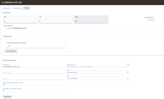

Btw why connector can be shared between hubs?
What do you mean?
Hub Mesh Enabled
I will look into it...
:grinning: thanks

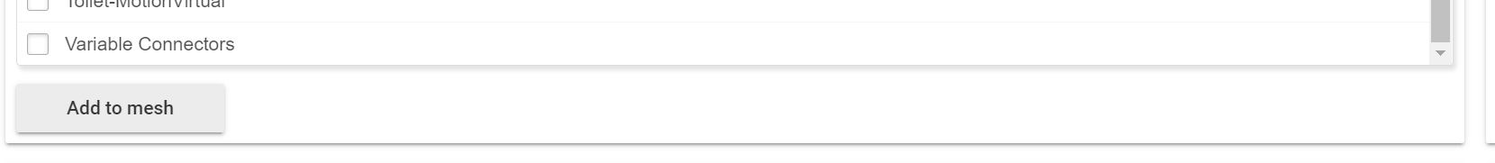

Have you tried simply sharing the parent device called "Variable Connectors"? That should share all of the connectors.
I do no see "Hub mesh Enabled"
They work fine via Hub Mesh. Not sure about "Hub Mesh Enabled"...
so if I use:
all my connectors will be shared?
I did not saw that until now
Yes, that's how to do it.
It works, thanks
