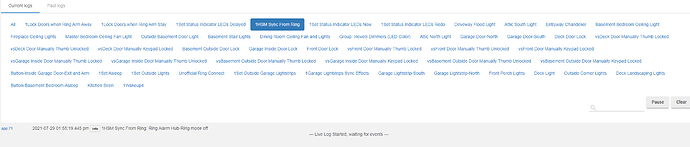

This event shows it seems to have triggered, but nothing actually ran (this is the only event in the log for this RM App):
It does look like it triggered, but the “Log: ‘HSM…” message didn’t get logged? If you haven’t turned on all logging for the app, can you do that to see where it fails?
