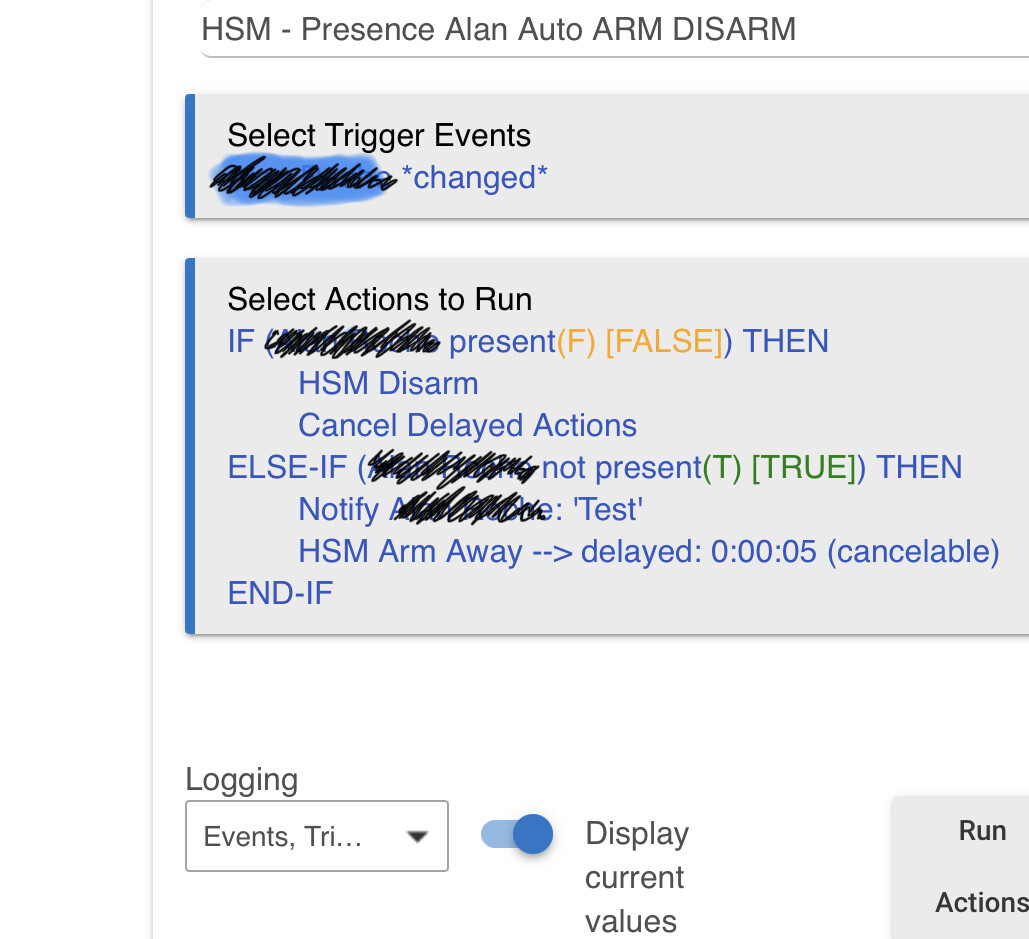

Having problem with a rule which worked perfectly before the upgrade yesterday. When it triggers it never runs the else / ARM.
Any ideas ? It’s worked perfectly before the upgrade.

Deleted and added the rule again. Appears to be working now will test over the next few days.
I find with most updates, my Ring integration, Sleep Number bed integration and a small handful of RM Rule won't work after an update. I just go in, poke around, done to get out and all seems to be well again
Good luck
Same issue here with presence. If I run actions from the rule it works. When the trigger occurs it logs the trigger event but the rule doesn't fire. I've poked around and saved again but it didn't fire again this morning. I'll delete and recreate it when I get a chance.
Yep 100% what happened to me. Removing and recreating worked for me.
