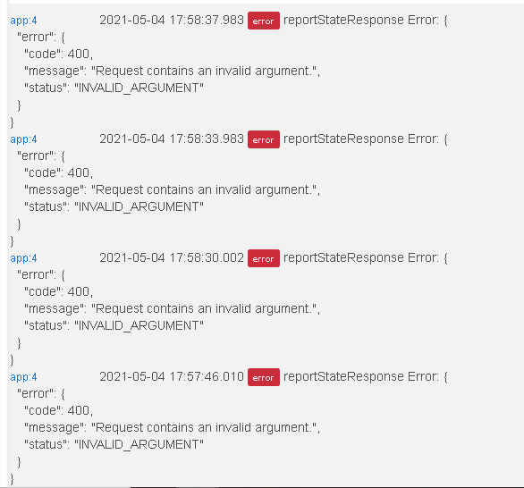

Would PM logs and screenshots help? Seems to just be the html attribute.
