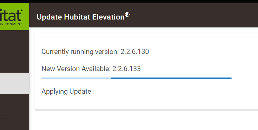

My development C-4 hub will not update to 2.2.6.133. I've tried 2x now, and the same thing happened in both cases. I get to the screen below and it never continues from there.
After the 1st failed attempt I did a soft reset, then rolled the platform back to 2.2.6.130 and restored the backup, which gets it working just fine on 2.2.6.130 again.
Tried the 2.2.6.133 upgrade again, and same result - this screen has been up there for 30+ minutes:
Rolled back to 2.2.6.130, and it is working fine on that version. :man_shrugging:
Mine updated just fine.
In the end, since it is one of my dev hubs with no z devices I just reset it.
After that it went to 2.2.6.133 just fine. So maybe I goobered up the database at some point in the past or something.
No worries! My other 4 hubs upgraded to 2.2.6.133 with no issues.

I literally just had this on one of my C4's going from 2.2.5.131 to 2.2.6.133, it took something like 40 minutes to "verify" the update and then a similar amount of time to apply it.
I think mine was likely memory / load related, since it was one of my live system C4's with 60 or so ZigBee devices on it and been running for a month or so (free memory decline, slower UI, etc). I probably should have rebooted it first to give it a clean memory footprint, will probably do that on the other C4 when I update that one.
