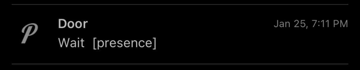

I upgraded earlier this evening and just noticed that the wait statement seems to alter the %device% and %value%

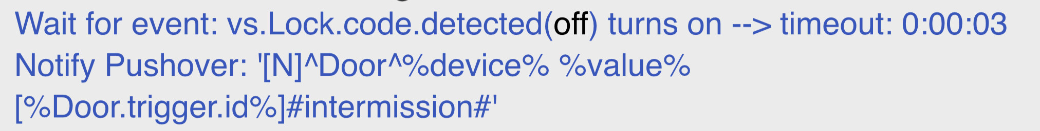

My RM included:
And my pushover message came through as
I guess I will need to copy the device and value to LV before the wait??
Note: I am using the modified pushover driver that allows for priority, titles, and sounds. Maybe I should try the official driver.

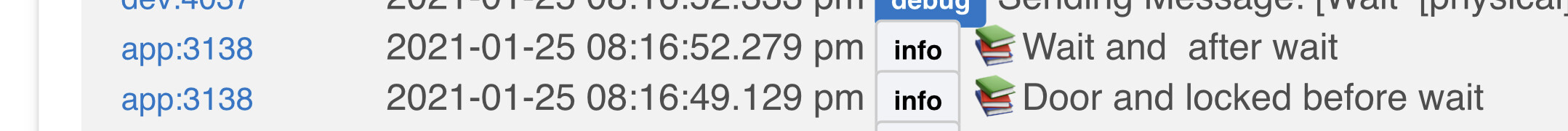

I will also add log messages to see the values. Maybe I posted too early.
Yup. Just verified that the wait statement now updates the %device% to ‘wait’
And the %value% gets blanked out.
