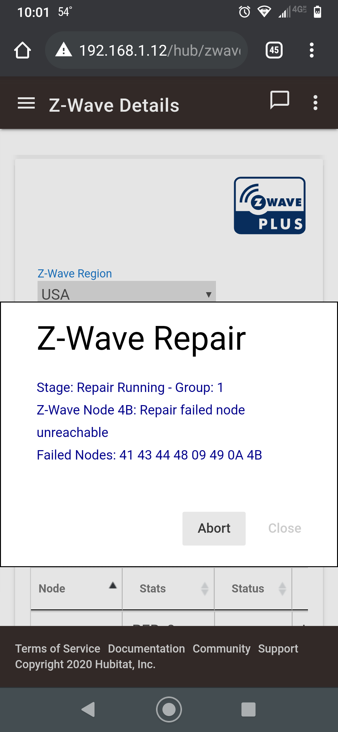

I moved my hub today so was running repair to make sure that everything was able to communicate. During the last repair, I started getting the dreaded
Z-Wave Network responded with Busy message.
Logs
Z-Wave Repair results
Current experience:
  • Control of any zwave switch from hub/dashboards silently fails (no logs)
  • Z-Wave reports from motion and contact sensors and switches are being received and handled
@bcopeland I have captured the html from the zwaveInfo pages and json from zwaveNodeDetail in case they are helpful.

Good question. I had a few devices that were responding slowly, but mostly figured it couldn't hurt...
No ghosts. One device (0x34) which is offline (and showing FAILED in z-wave details, as expected), but otherwise all devices are OK.
