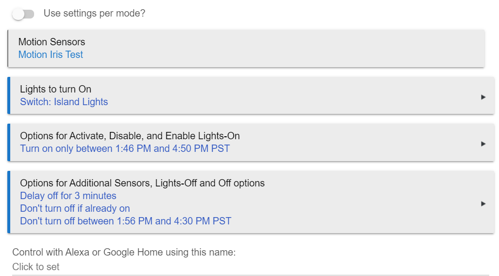

Motion lighting settings:

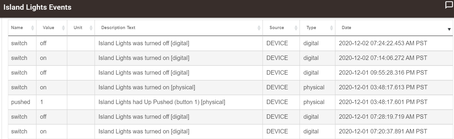

The lights were off (turned off via Google Home command some time previous), but were not physically touched anytime near or during the run-time of a test I just tried now (9:07-9:00 AM).
Not sure why the automation thinks the lights were turned off manually, the last time the light events show a manual push was yesterday. I have not used the light switch this AM at all. The same automation (originally set to run between 6AM and 8:30 AM also failed to run this morning when I came into the room a little after 7AM.
So seems like every time the automation runs it thinks that the lights were just turned off manually.

More testing...I removed what from the logs appeared to be the offending setting (Don't turn on if turned off manually," but the automation still failed w/the same error. Something was borked.
Automation, w/the "Don't turn on if turned off manually" setting disabled.

THere have been no manual operations of the switch. The device logs don't have any manual button press events during that time.

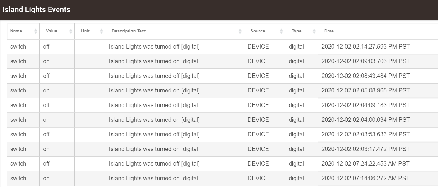

I turned the lights on and off a couple times from their device page. Tried the automation again and got the same message in the logs about manual off:
I removed the "Don't turn on if turned off manually" setting, saved the automation, and ran it again. Same result. Even when I edited the automation to change the time period, the switch cannot be turned on by the automation any more.

There's a known bug wrt having both options "Don't turn on if turned off manually" and "Don't turn off if already on" selected. The two are mutually exclusive, and only one can be used in one instance of the app. You discovered what happens, the app gets into a state where it can't be activated.
That wording is awkward. It means turned off other than by the app.

It didn't seem to matter if I turned the light off from its device page. I was doing that in between tests while I waited for the motion sensor to return to inactive, and doing that did not seem to affect the automation running normally. I'll check that again, just to be sure.
