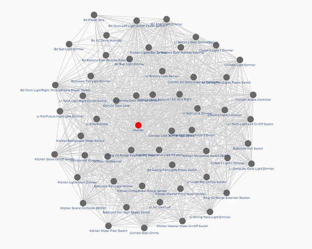

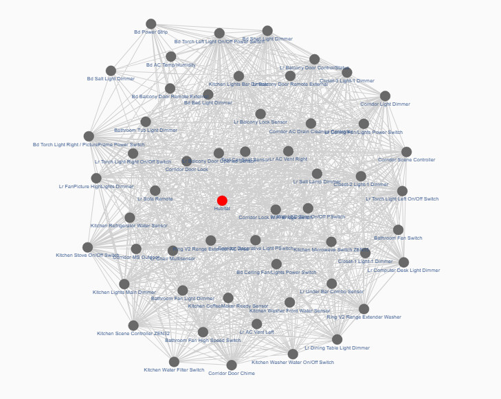

In addition according to the ZWave Graph there are no Repeaters (blue dots) but definitely there are plenty on repeaters:

From other posts, that's just what the graph looks like on JS. I've never looked at mine - it has no value to me.
