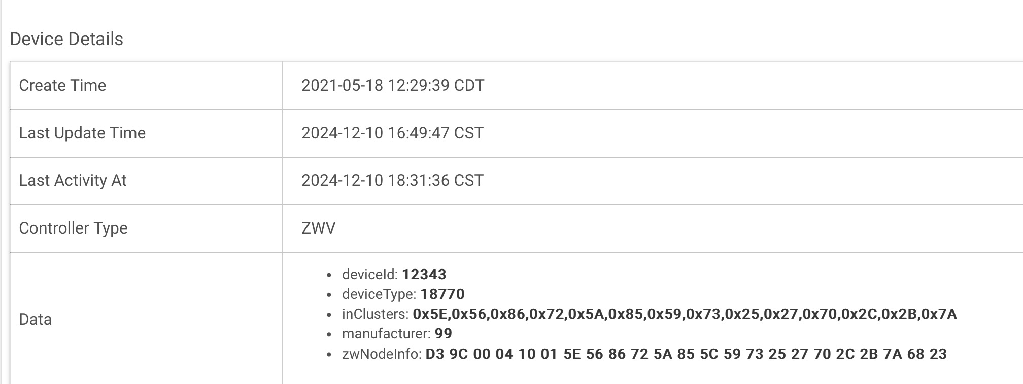

This switch has been reporting reliably for YEARS and it is not the only non ZW+ one I have that is rock solid. Trying to figure out why this one is now not. Any ideas? I've done numerous Z-Wave repairs, my hub doesn't offer the Z-Wave driver update button, rebooted the C-7 several times..... Removed ghost devices about a month ago. I'm missing something but I can't figure out what.

Not much help, just an observation, your device is showing 0x5e inCluster, a Z-wave Plus component.
Might be newer than you think.

If it was non-plus it would not report on its own ever. AFAIK only plus devices report on their own.
Did you power cycle the device? Which in some cases may break Jasco devices from a specific time period, but also may solve the problem.
Towards the end of their run, Jasco had 500 series switches that did indeed report physical actuations, even when using an accessory switch in a 3-way setup. I had a batch of them. They did not show the 0x5E cluster though, which leads me to believe the OP's switch is of the Plus variety.
